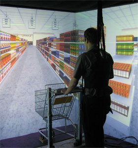

In most AR/VR environments for physical therapy, activities are conducted in an environment that mimics daily life to produce daily activities such as dressing, opening doors, grooming, and completing kitchen activities (Merians et al., 2002). VR applications in physical therapy also feature simulations that replicate the involvement of health professionals (Kilic et al., 2017). In this situation, health professionals cannot rigorously test their patients’ outcomes and health (Lalloo et al., 2015).
Merians et al. (2002) explain earlier research about physical therapy through VR and AR for patients who have experienced a stroke. This research case aimed to create a functional range of motion, movement speed, fractionation, and force production throughout an interactive and motivating environment in which practice can be intense and feedback can be produced as individualized treatments.
As demonstrated in Figure 2, therapy using AR/VR is mainly targeted at solving specific problems in daily lives. However, the aim of the use of AR and VR in the therapy realm has extended beyond solving specific therapeutic problems at the clinic to diversifying the user’s experience and giving pleasurable emotion. To potentially use AR/VR in the therapeutic realm, the experience should provide an expanded physical interaction that includes the entire body. This will require continued innovation and technology as well as the exploration of design research for embodied interactions that better support a human’s activity for therapeutic purposes.
Creation of experience that mimics patients’ daily lives for VR physical therapy (The University of Pittsburgh VR grocery store simulates the challenge of shopping for people who have balance disorders. Photo courtesy of the University of Pittsburgh Medical Center.)
